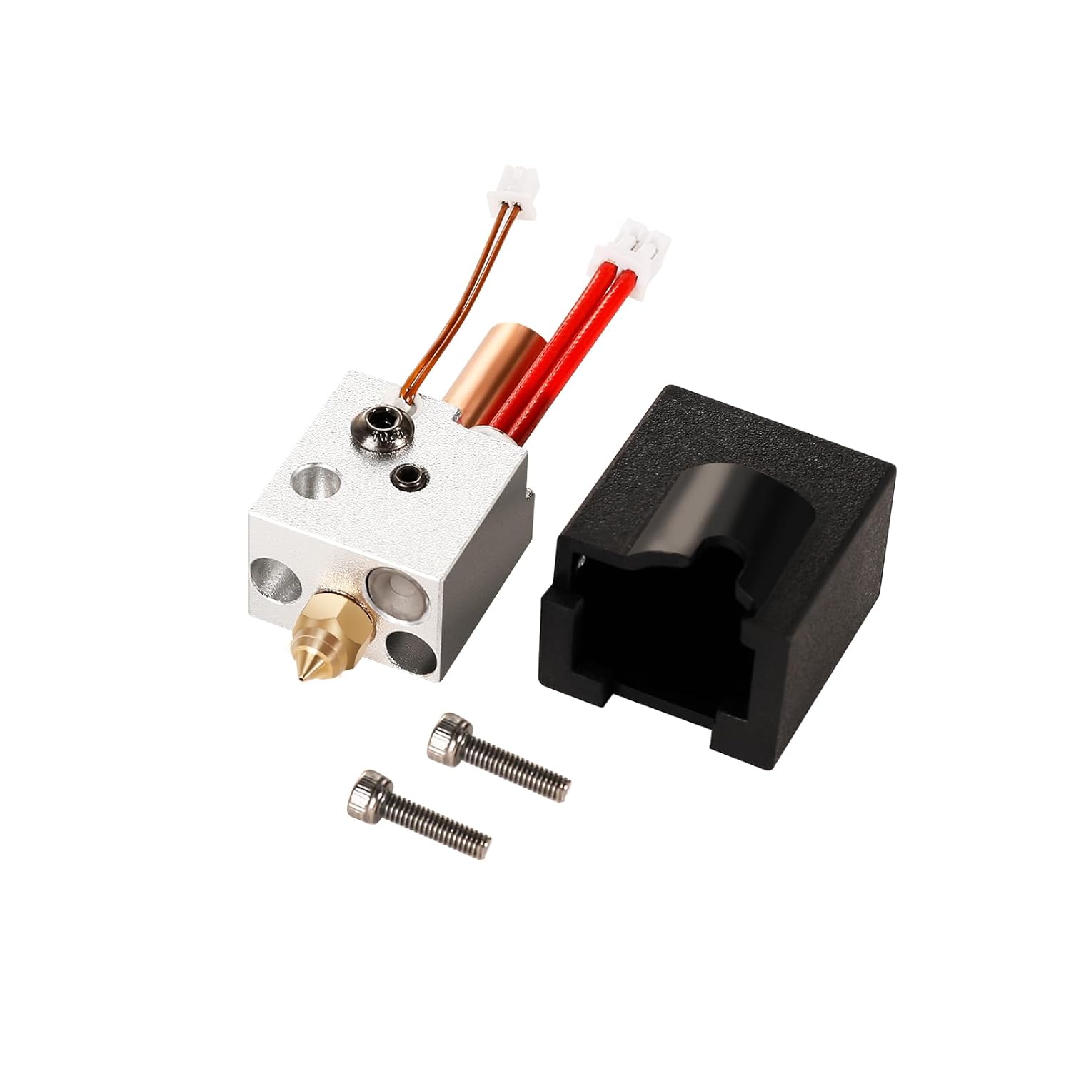

I remember it spiking low, so I should change the thermistor? What is the model of the thermistor and where should I buy it (USA)?
The thermistor itself is generic. The plug and wire length are more specific.
Sovol doesn’t sell the thermistor separately. The complete heat block is available at Sovol’s Amazon store.
If you are willing to splice wires these are available
