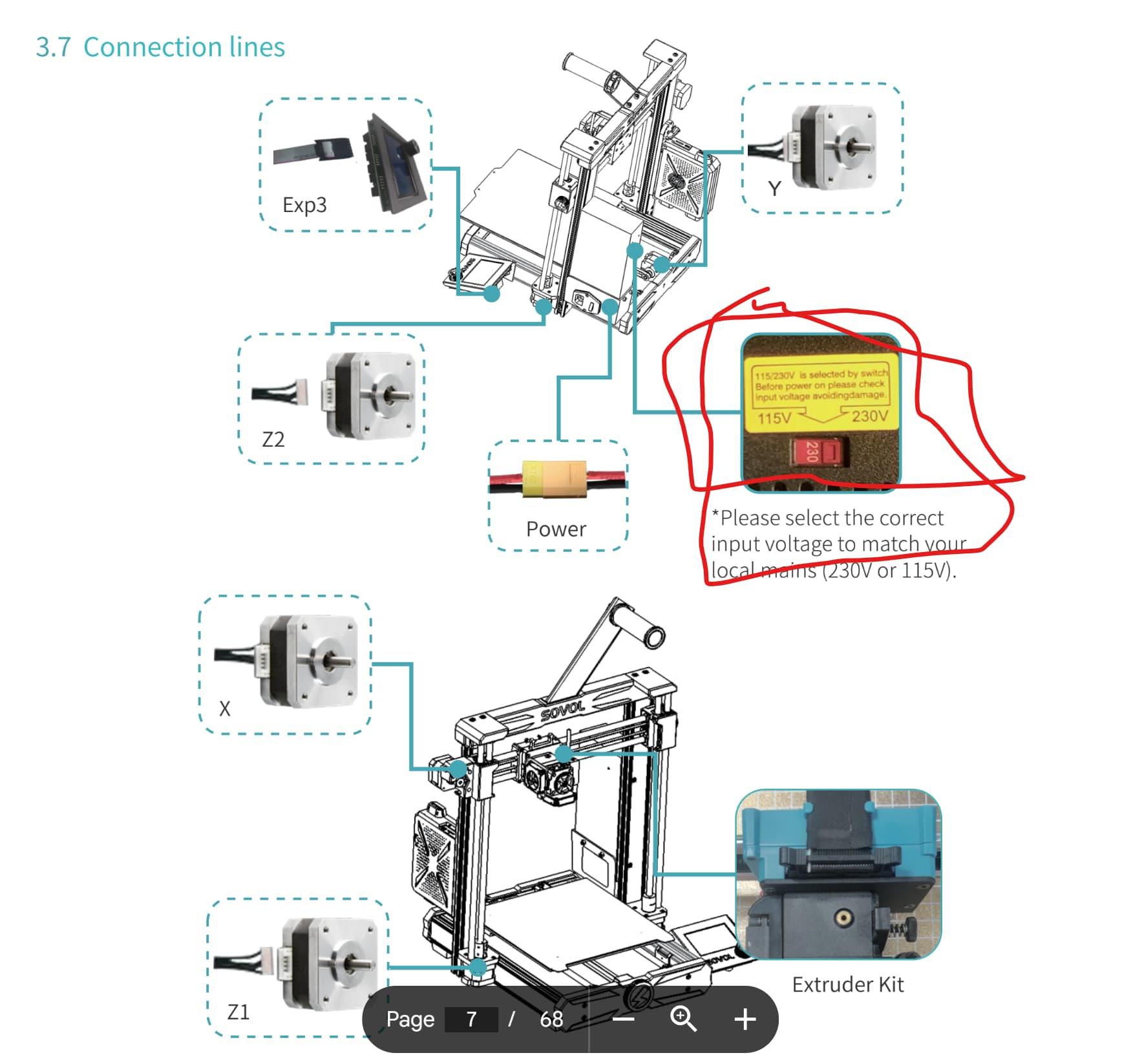

Check the voltage selection switch on the power supply My SV07 arrived ser to 220V. I assumed since it had a US plug it would be at 110V. A had a couple anxious minutes before I remembered to check the basics first.
There is an opening in the outer casing through witch you can access the selector switch on the internally mounted power supply.
Thank you. Yes I checked the wiring and had 2 others check it too and it was wired up correctly. Also checked the voltage setting and that was correct for uk plug. I am resorting to sending the whole thing back :frowning:
