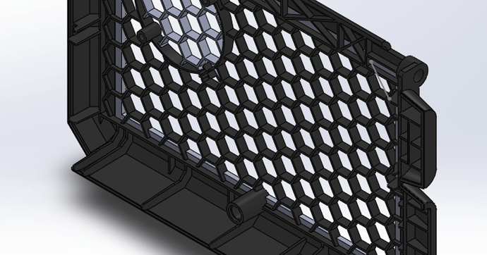

Maybe something like this:
Good catch. I linked the wrong design.
