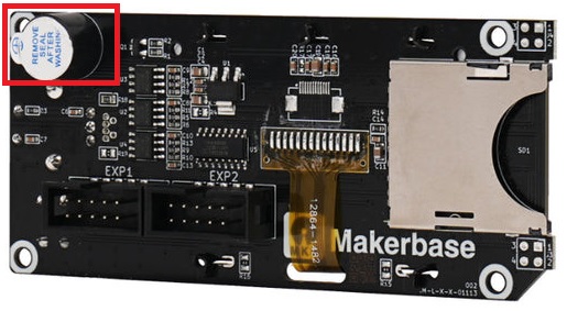

I noticed a piezoelectric buzzer on the store front Sovol Zero original screen picture.
Ref: Sovol Zero/SV08 3D Printer Original Screen

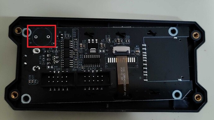

Question marks abound… I opened my Sovol Zero original screen…
and found this ![]()
So taking one for the team and being from a era where sometimes it just needs “a” part I tried this… Amazon.com: SoundOriginal PC Motherboard Internal Speaker BIOS Alarm Buzzer (3pcs/Pack) : Electronics with some breadboard jumper wires.
Sad to report no joy, silent as the night… Tested knob push, turn left/right, push and home the printer. As mentioned, probably need more somewhere…
Good news, in the end my screen still works and my printer still prints :
Attempted HW hack completed… ![]()
I found similar LCD boards around the internet, but if the Zero is going to beep it’s going to take some work at multiple levels by folks with more skill in this area than I have.

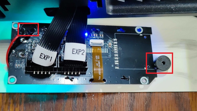

While the board omitted the beeper, the FET to drive it is still there, and it is controlled through EXP1_1 (aka PA8). So I soldered a passive buzzer like @MikeHides did and got it to work!
The CYT1008 (10mm) I picked out is just a touch small, I had to bend the pins outward slightly to get it to fit. A 12mm would work better.

Thanks to @rpcyan for figuring out the hardware/software side of the connection.
After a day of testing and playing around with tones and frequencies I am now alerted after a print.
Buzzer installed:
