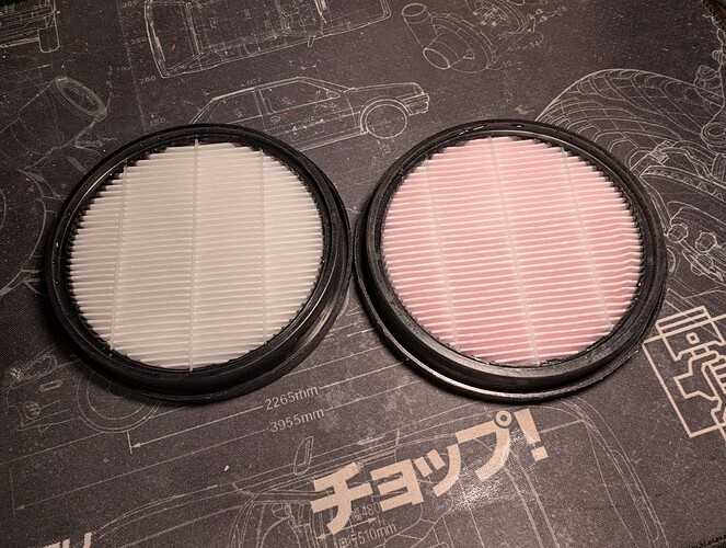

I designed a filter addon for the Zero but I only had anecdotal evidence that the smell of ASA was all but gone with the filter on the printer, turns out the filter is catching quite a lit of particles!

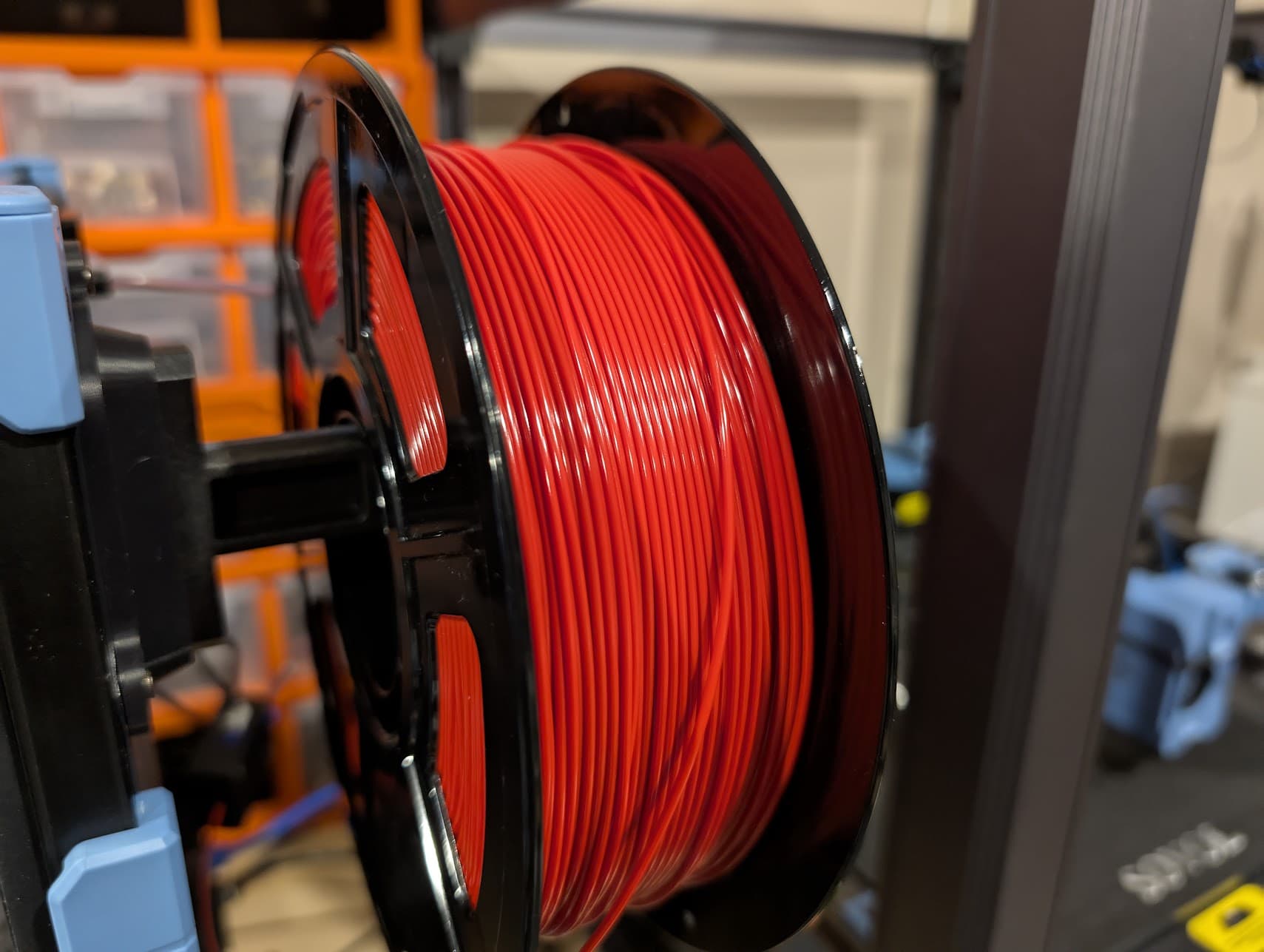

Filter on the left is a new clean filter, filter on the right has been on the printer for 4 or 5 days, it was printing mostly grey/black till today when I loaded up red ASA, the colour of the filter speaks for itself… this is only after 2-3 hours, maybe 150-200 grams and yes, the exhaust block off plate is installed!
The filament is iSANMATE ASA from Amazon.

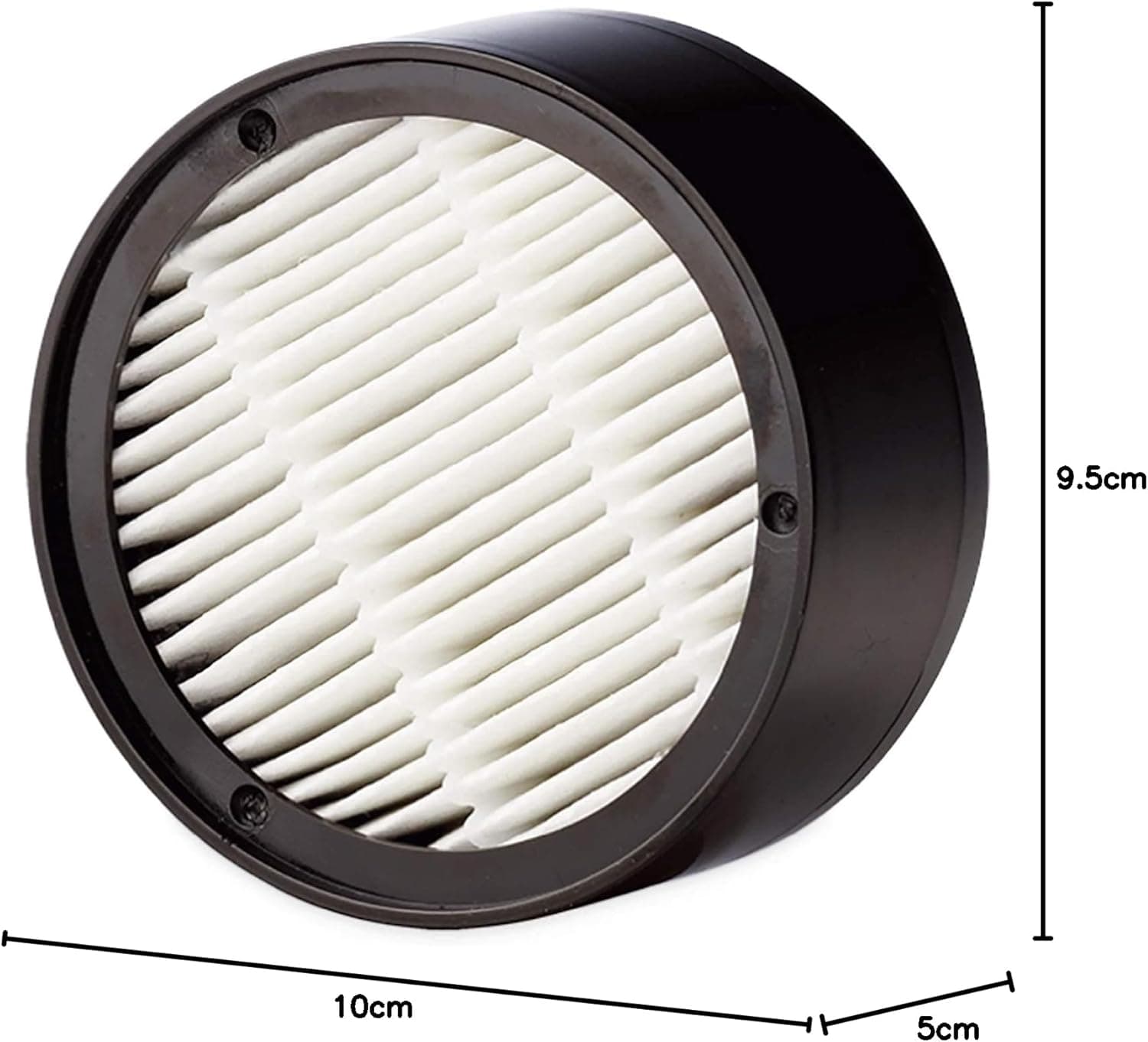

I’ve ordered this style that have a carbon cartridge, the Amazon listing says they are compatible with AV-P108 Air Purifier, keen to see how they work out.

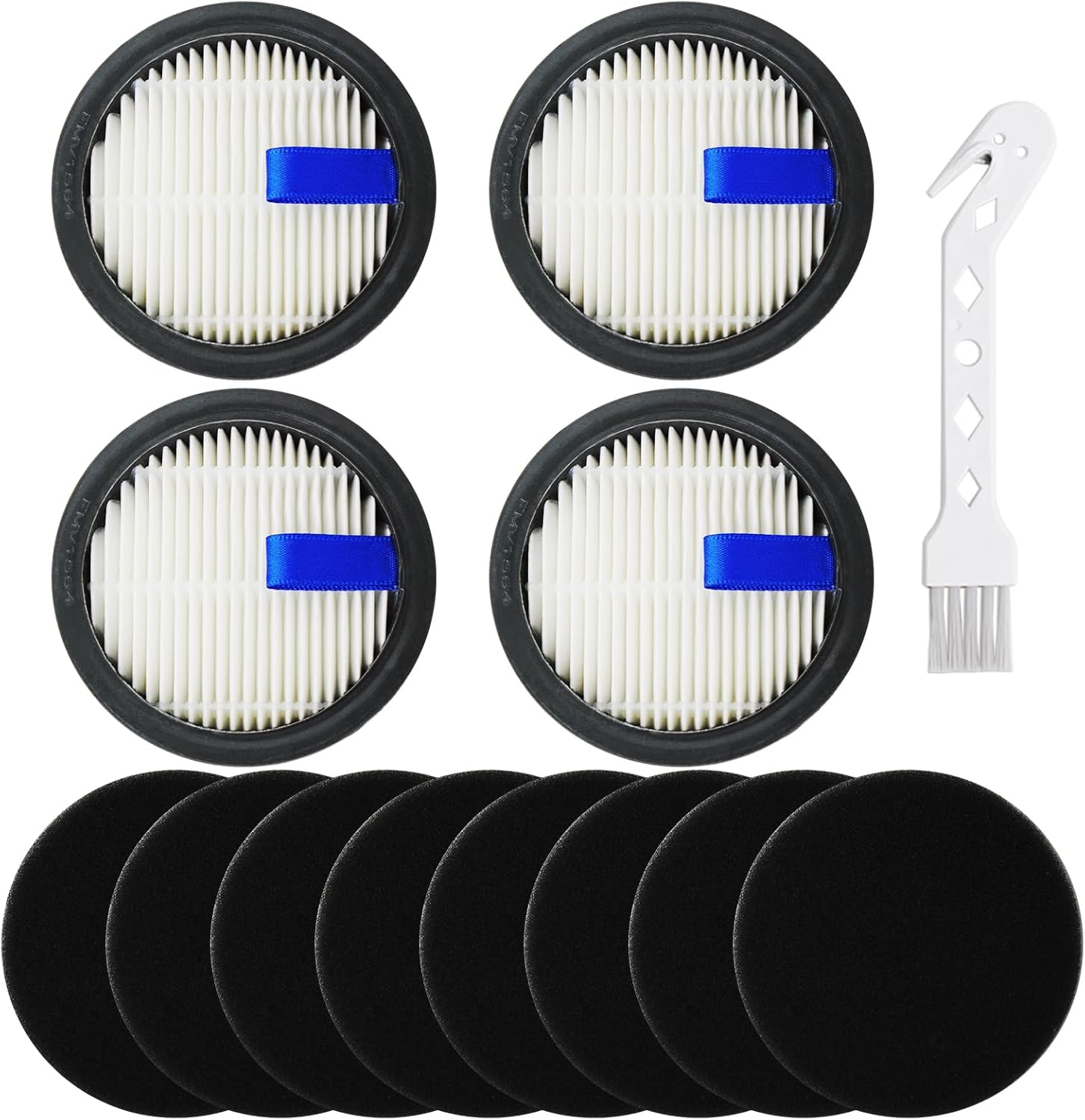

Filters came in today.
I’m not sure about using the foam filter, worried the heat & fan will blow it into pieces all over the place.
