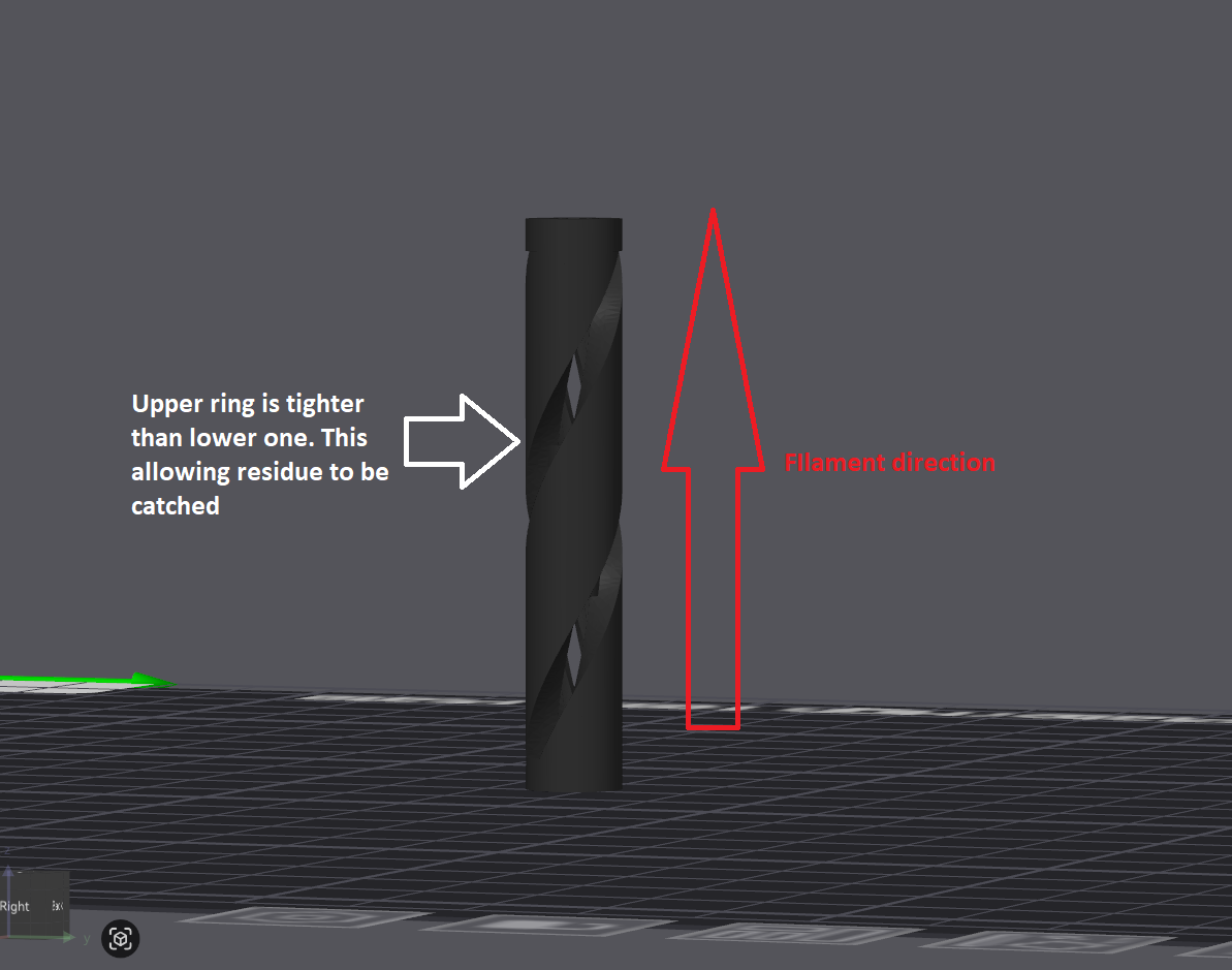

I’m currently trying to create tube connector with holes which allow filament residue to escape without sacrificing tube tension.

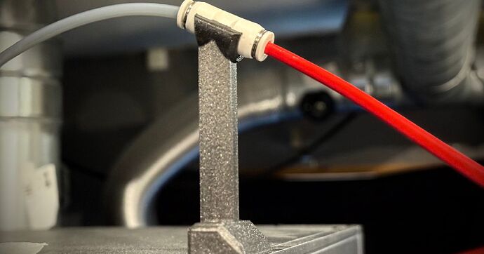

You can try these, I don’t own a MAX.

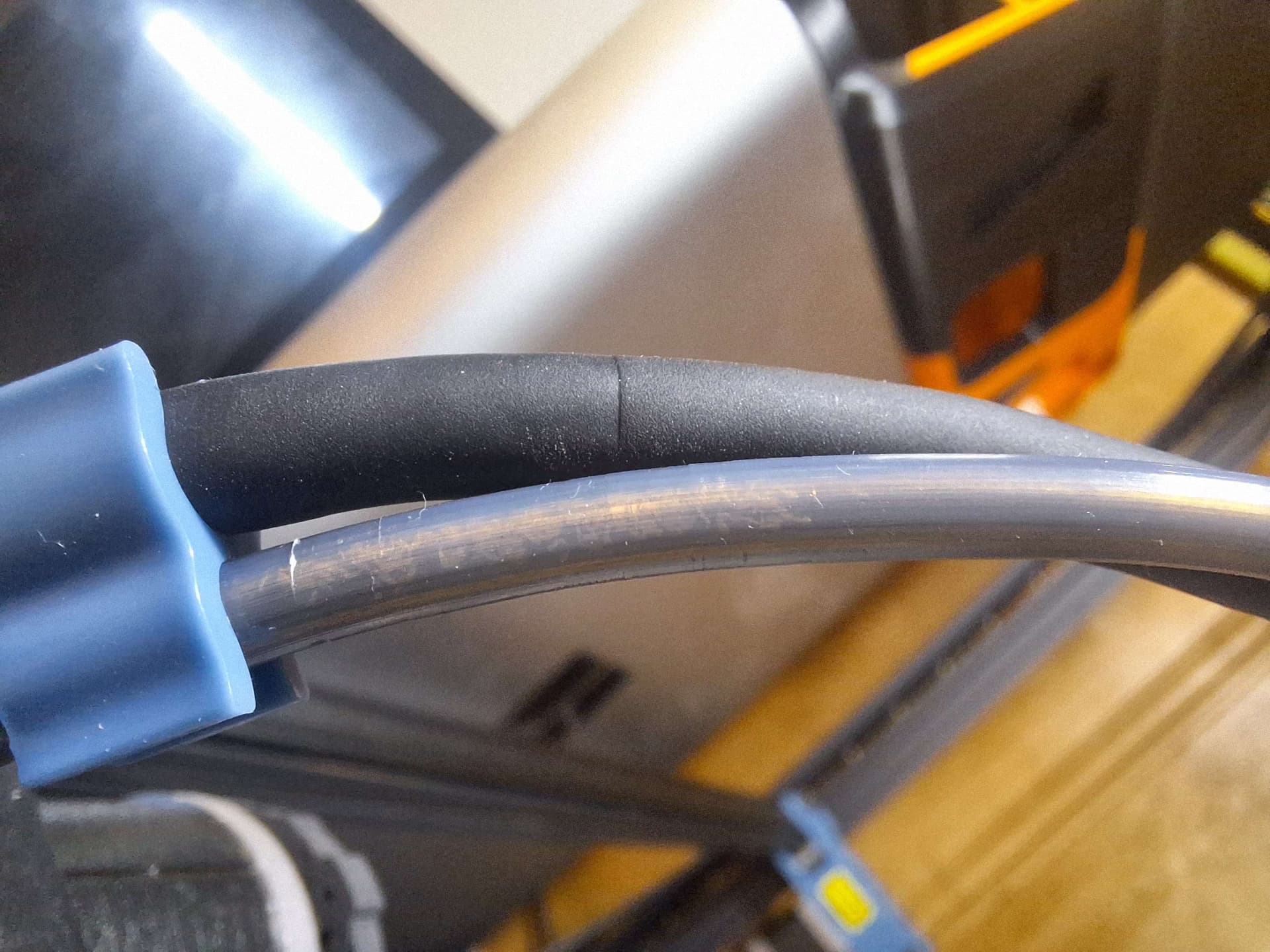

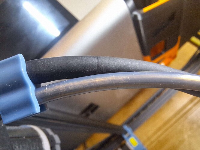

and this is how messy are PTFE tubes after only 8 hours of printing
What kind of filament are you using..??
It looks like it’s tearing the tube up.
It’s default PLA, and its not a tube tearing up. I used compressed air on empty feeder assist after print to clean it up after that table looked like sprinkled with artificial snow.

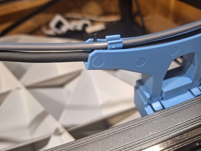

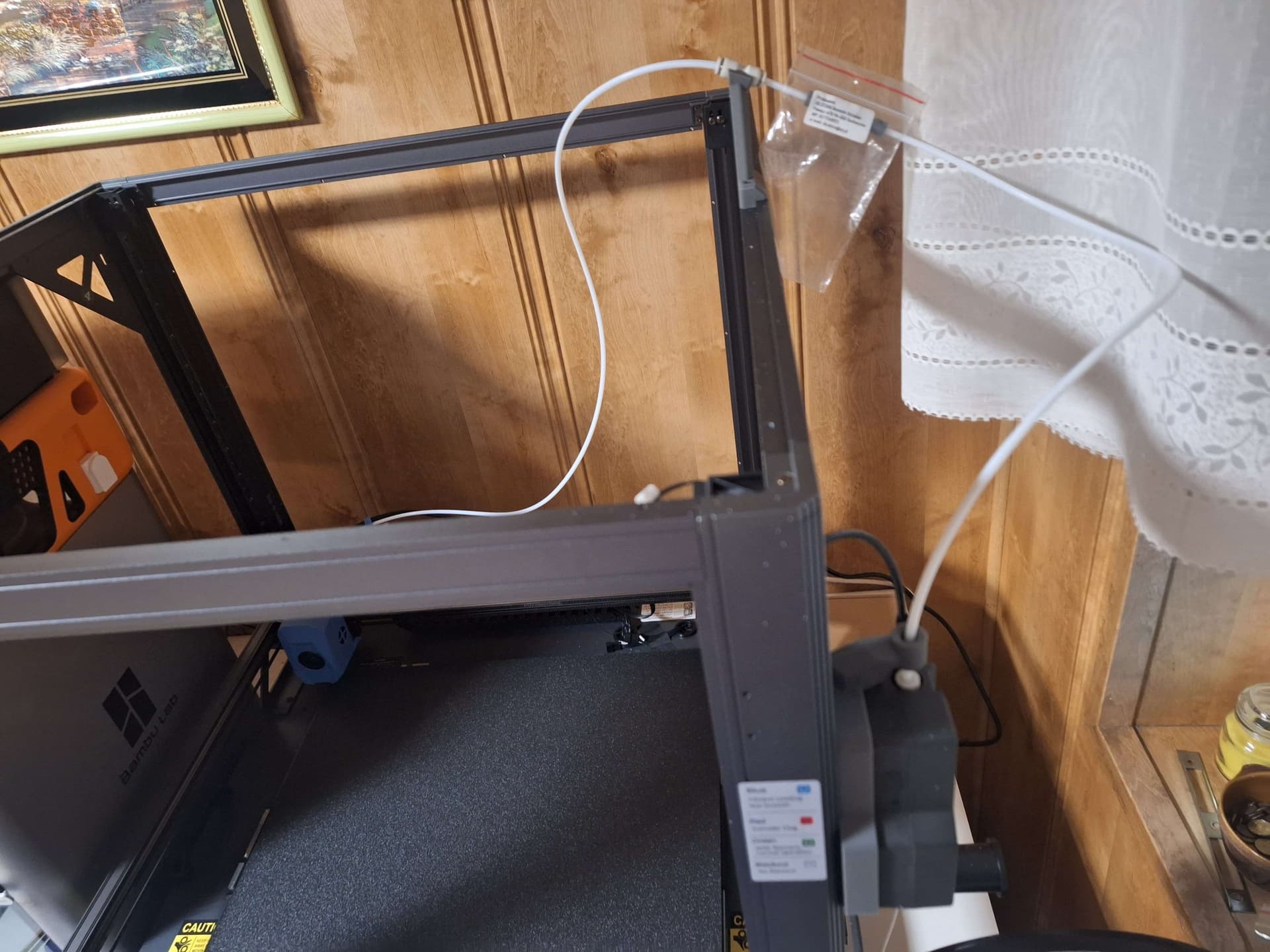

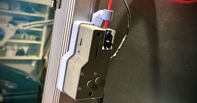

Ok before I change to dual extruder setup this is what I achieved so far in the meantime.
I changed PTFE to shorter one (to reduce friction) but long enough to support whole volume, replaced old PTFE holders with new ones from Printables, and also added residue catcher.
Here is my prototype tube connector to allow residue to escape:
pressfit PTFE cleaner.step (398.3 KB)
pressfit PTFE cleaner.f3d (429.0 KB)
