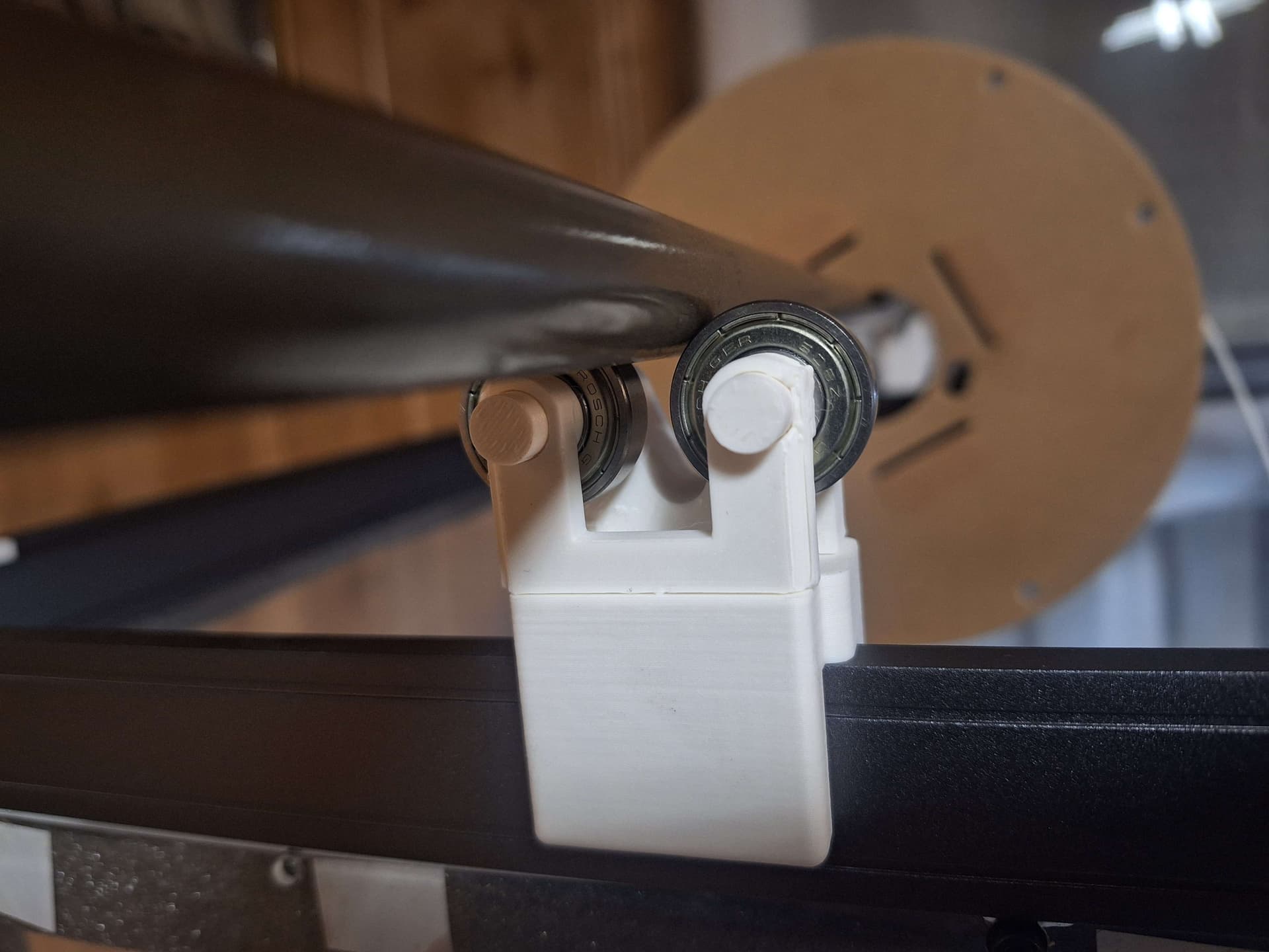

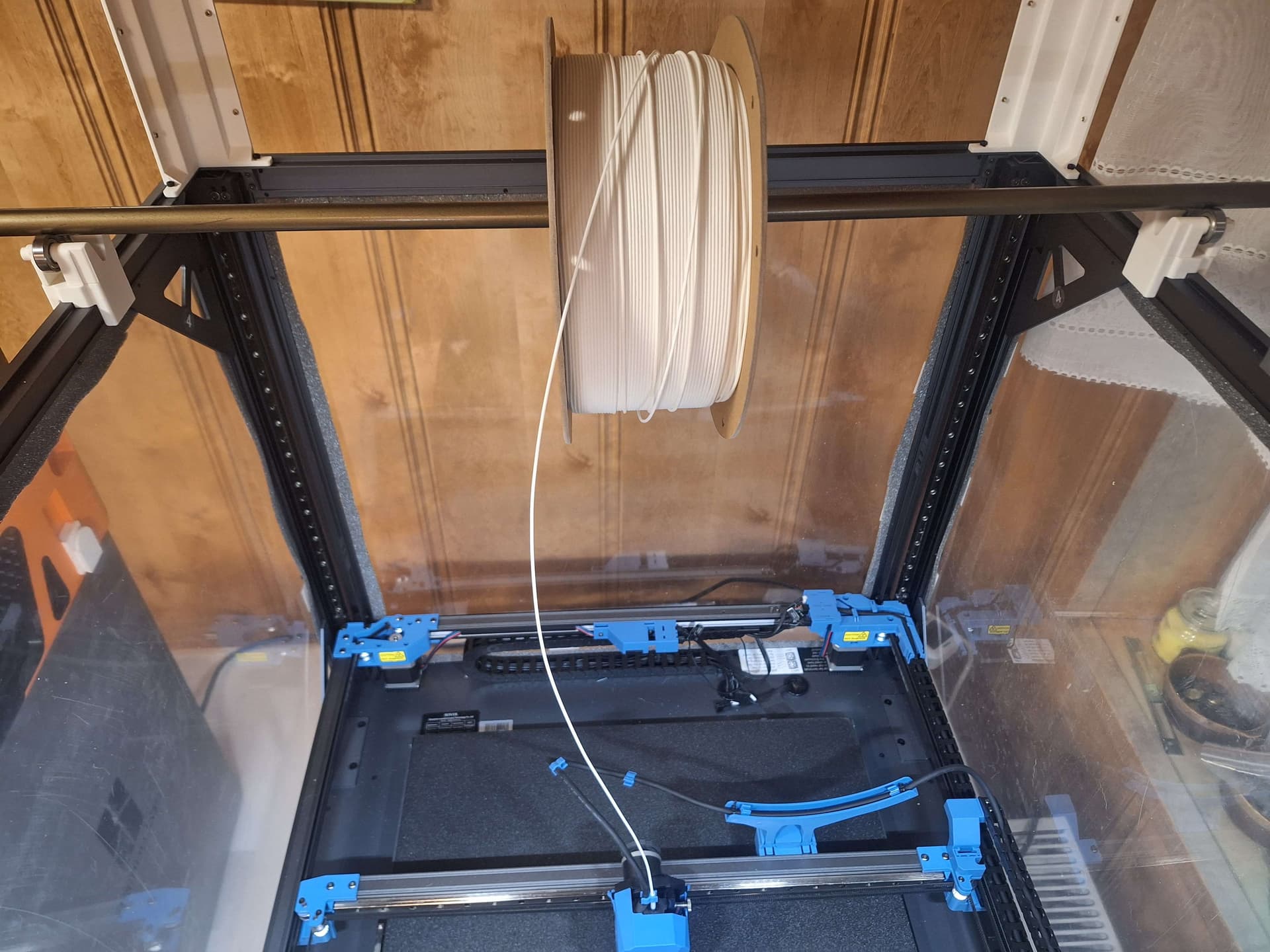

I had different problem. I have filament that is a little bit rough, has more grip than e.g. Bambu or Sunlu but nos as much as PLA Glow. The feeder cannot even grip on it, because you know circumference times length is merciless on MAX.
So I create this monstrosity but it seems to work:
I did remove external feeder references from macros. My next step would be converting feeder to just second extruder working in parallel with toolhead extruder.
That is not a monstrosity. looks like an elegant solution as long as you don’t need a top panel.
