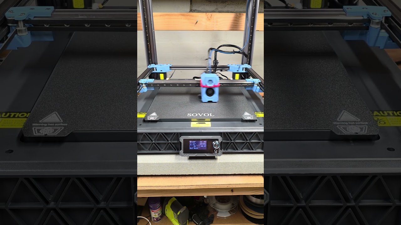

I received and installed the factory Eddy sensor. It is working well so far.
hello. I also upgraded to eddy official yesterday. I have a problem with the height of the nozzle cleaner. It's too low so the tool head rests on the bed and scrapes the bed. The two screws that hold the small cleaning plate have a higher head and almost ripped off the head cover. I don't know how to adjust it. Any calibration doesn't help because the nozzle is cleaned only before printing.
