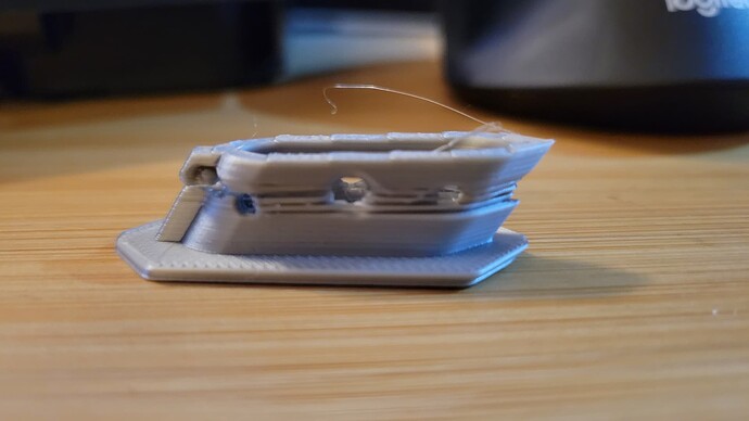

Hi, I have had my SV06+ for about two years. I have recently started having problems with PLA filament delaminating when it prints a small-ish surface area. The Silk style of PLA is worse than the normal style, but they both have delamination problems. It seems to do fairly well if I’m printing something that has a large surface area on the layer and has sparse infill in the middle. But if the area of the layer is small, and it only prints perimeters and gapfill, the layers do not stick to each other very well.

I have printed small surface areas with this filament before, at higher speeds and lower Extrusion Multipliers, with no problems. I have tried tweaking the hot end temp up and down, the default speed up and down (I went as low as 15mm/s), the internal and external perimeter width up, I have recalibrated the Z-offset and the Bed Mesh, I have cleaned the nozzle and extruder, I have tried brass and nickel plated nozzles, I tried running the parts fan at a lower speed, and I have run the filament through my filament dryer three times. It has produced a single useable print, but when I ran the same file a second time within a 2 hr period, using the exact same filament, it was delaminated again. I have been beating my head against a wall for two months now. Does anyone have any suggestions?

I tried printing the part in all four corners of my print bed. The delamination seemed get better if I printed it in the front left corner. All of the others look like the attached photo. I printed a temp tower to figure out the best temperature to print this filament at and 205C was the best. Now, if the print does better in the front left corner of my print bed, I have two questions:

Well, I spoke too soon. That one corner produced one good print. All of the subsequent prints I tried were delaminated like the picture above.
Here is a pic of the temp tower that I printed a couple of months ago before this problem became so prominent. To me, the best print quality appears to be the 205C section. I have tried printing this part with temps between 195 and 220. They all produce the same delamination.
I was hoping it was printed recently, but that tower still shows problems.
The tower has some extrusion issues…so does the other pic you posted.
