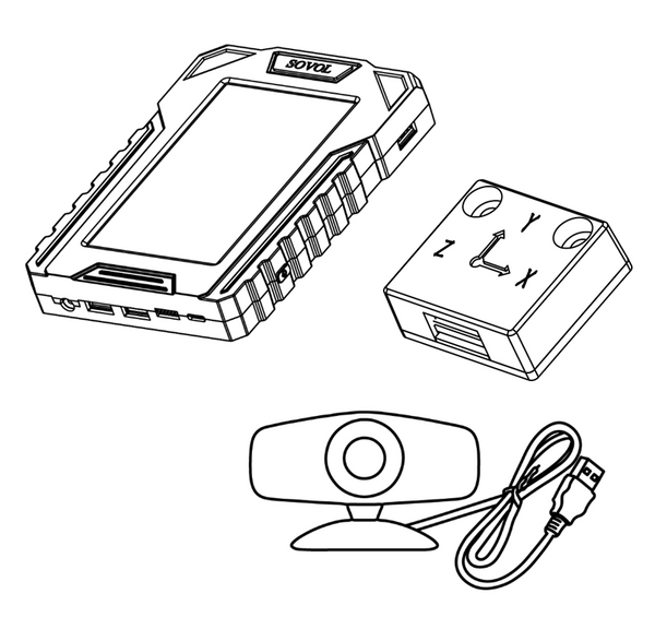

Does anyone know if you can plug a USB webcam into the control pad and show the stream through the web interface?
I can see that there is a section for camera in the settings but it doesnt explain a whole lot…

Definitely not plug and play. You do have to SSH into the box and have to add some software there. Once that is done, it’s plug and play. Sovol does have a site that details how to install the support software on the printer however. This is what I followed:
How to use external camera on SV07 | Sovol3d BLOG blog (archive.org)

FWIW, with the latest SW on the SV07+, which is:
mks@mkspi:~$ cat ~/.DebVersion
 Version: 1.0.8-07P
I only had to add the camera in the web interface (fluidd) and then reboot the controller (“KlipperScreen” if you will). The necessary software (ustreamer, crowsnest, ++) was already installed.
