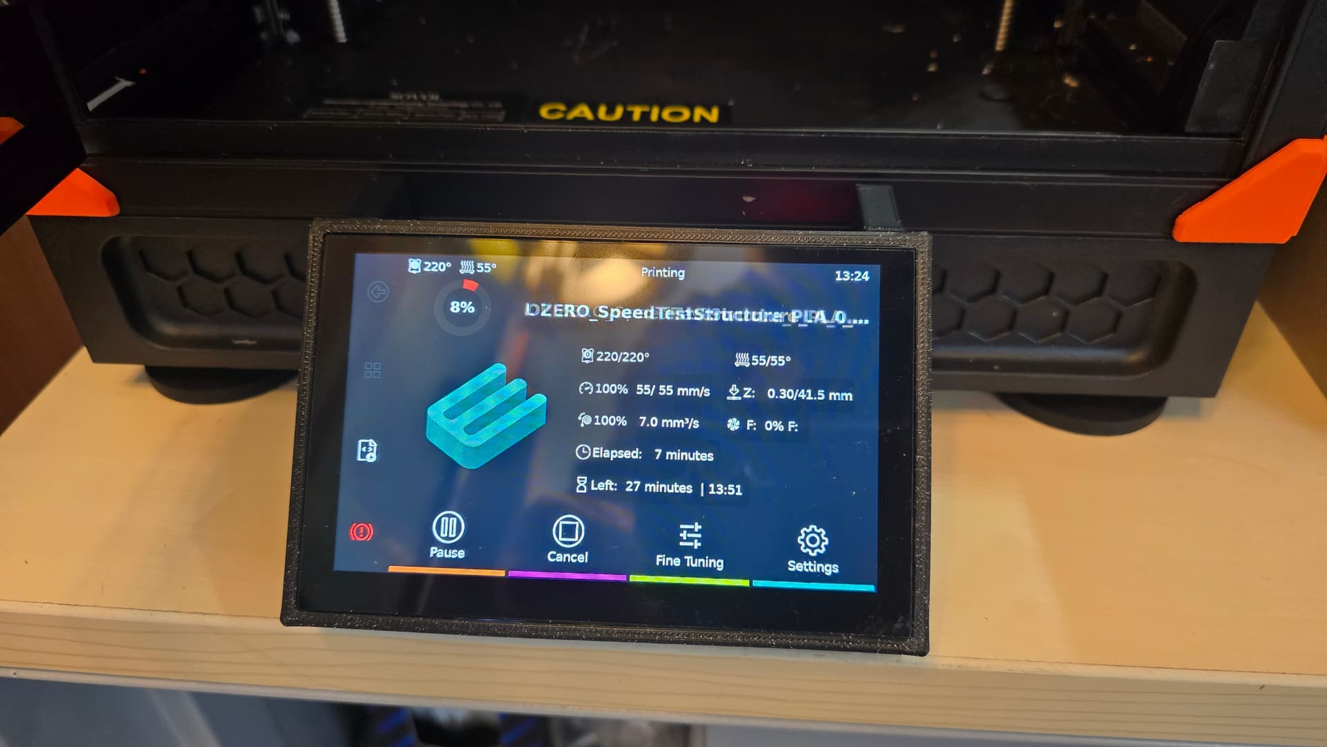

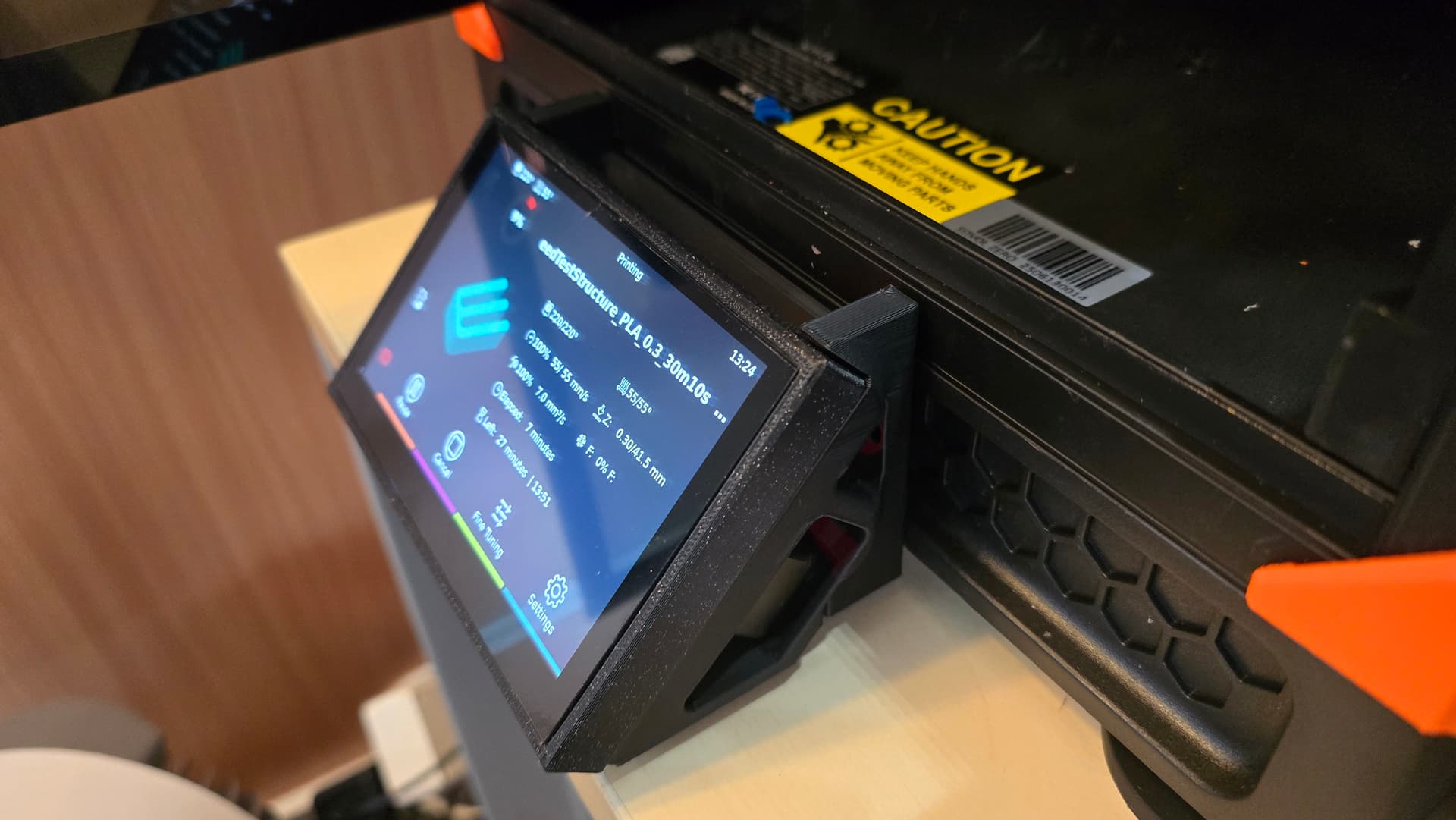

SV08/Zero HDMI Capacitive Klipper Screen is now on my Zero
First let me say that I use my Zero with an Ethernet cable & the display still works.
Here is a link to the screen:
Here is a link to the new mount:
Here are some pics of it installed.
Right now the old display plugs are just lying underneath the new display.
Over the weekend I will remove the bottom & find a place to attach them out of the way of the belts.
*** You have to change the Font from Medium (Standard) to Small or you will loose the bottom row in some settings & also you won’t be able to type in the console. ***
So far I like it, but I didn’t really know what to expect as their is not a lot of info online about this display.
One not so bad thing was the the kickstand was broken, but I mounted it so it really doesn’t matter.

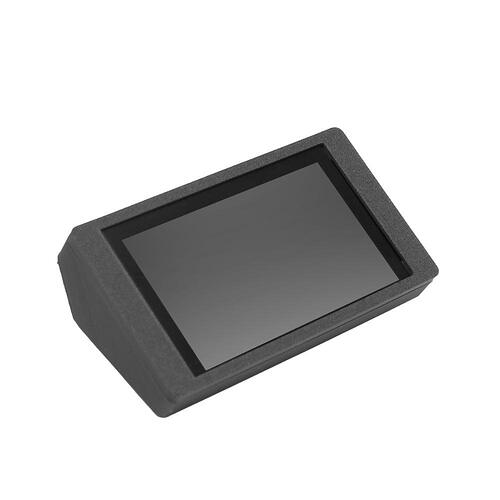

I plan on printing a new case, I just haven’t decided on a color yet…I am leaning toward Fire Engine Red.

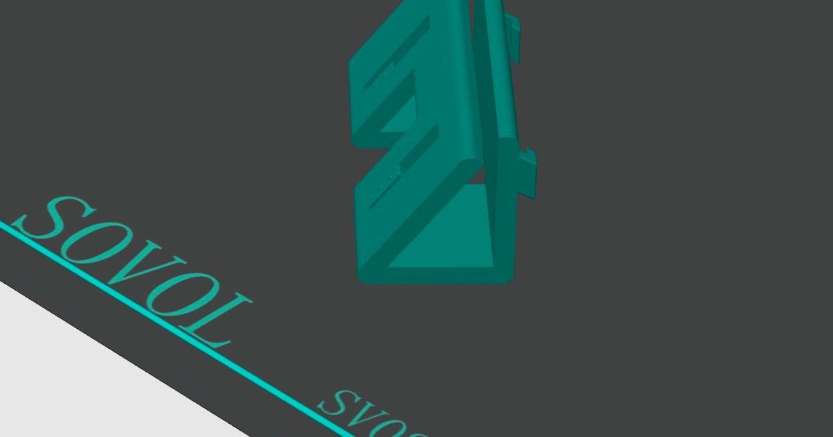

Which model for the case is this please?
Sovol gave me permission to upload them to Printables.

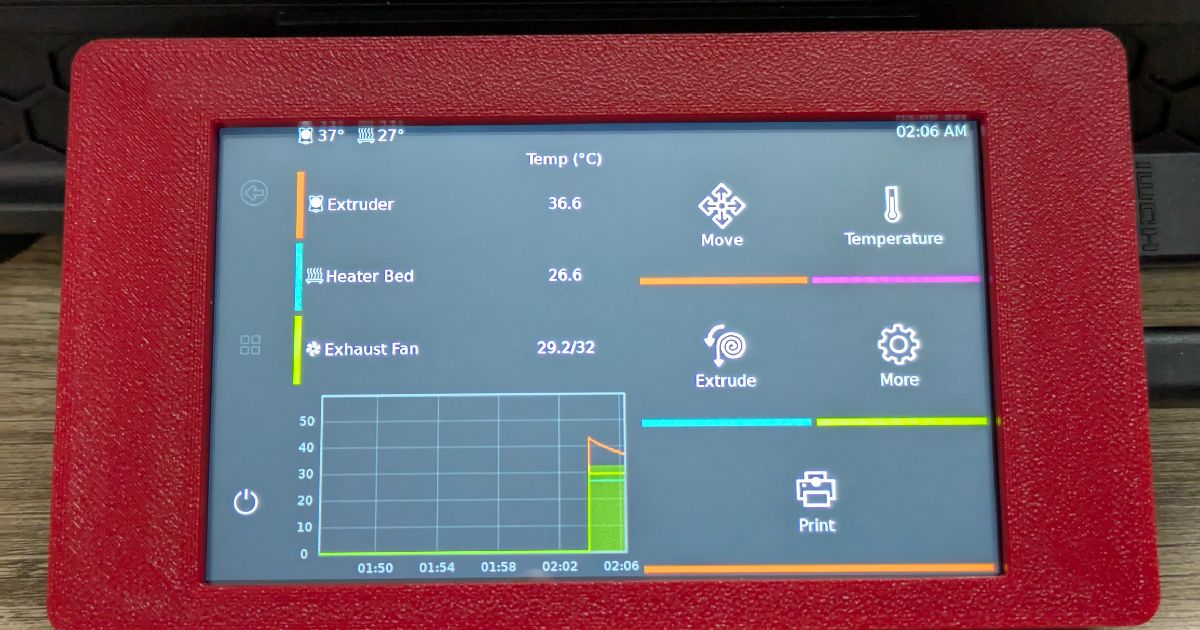

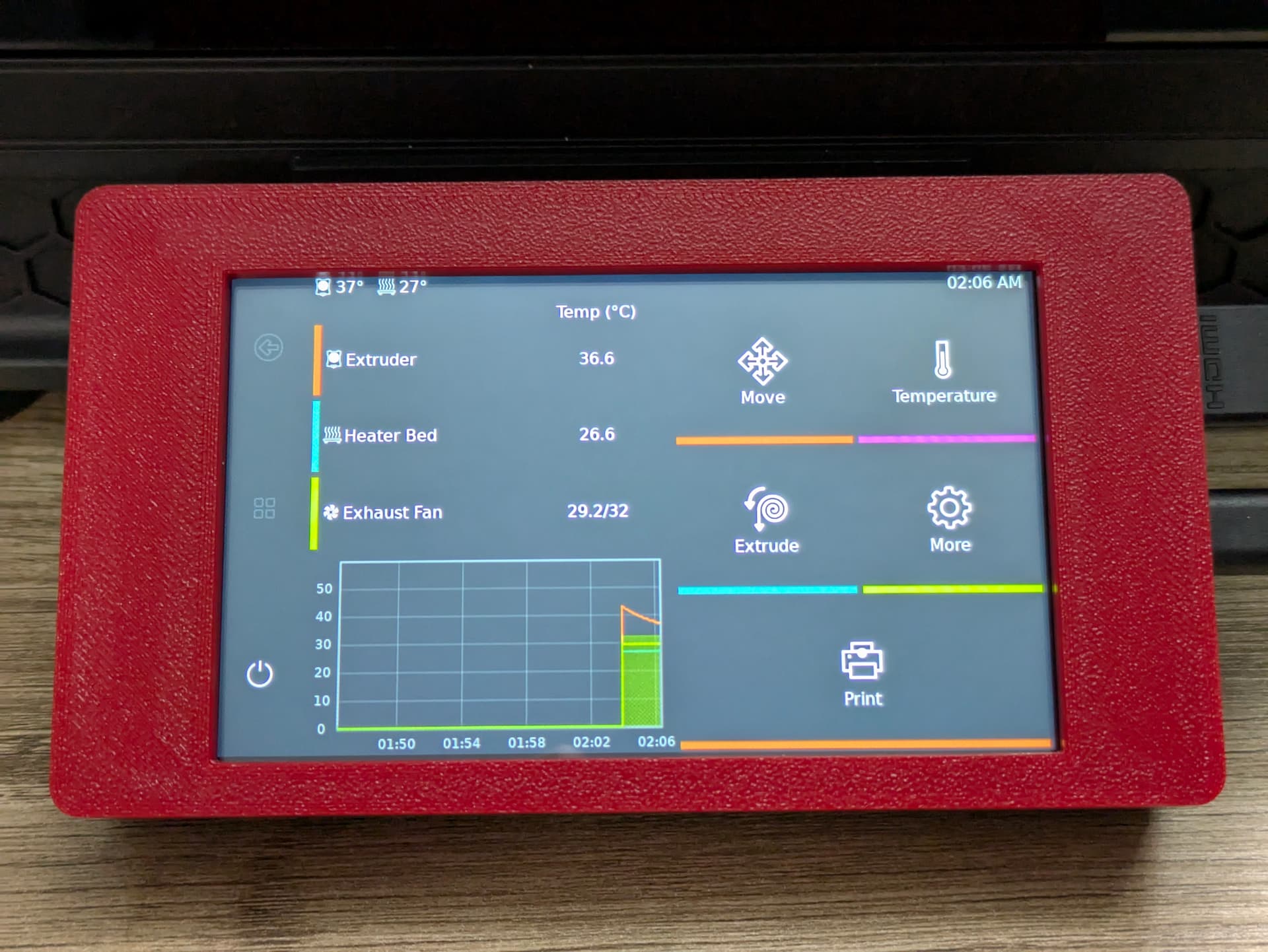

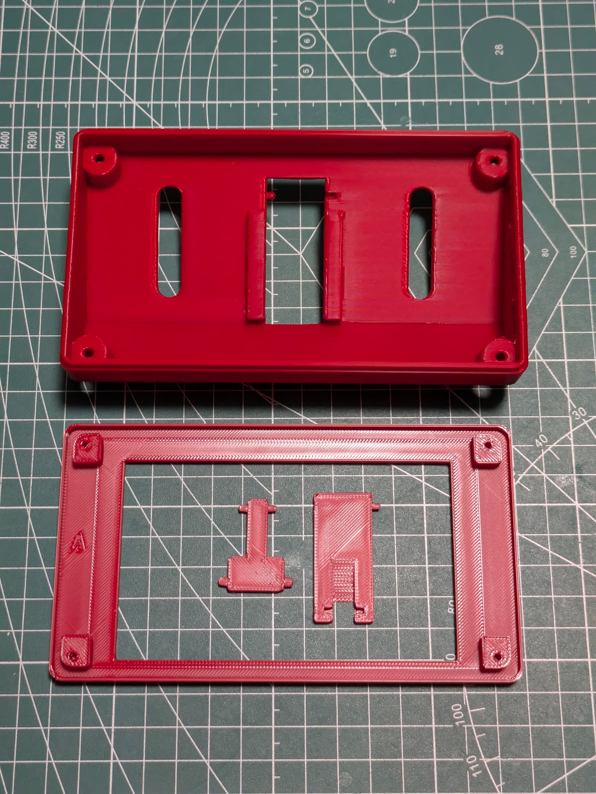

I bought a btt HDMI5 v1.2 (where cables exit at rear for cleaner look), and found a cover on Printables. Then I combined it with the sovol adapter bracket (also from Printables).
Altogether about US$34.

Do you have a link to the prints?
how did you wire the cables to the screen?
I’ve got the same display and currently the wires aren’t very neat
Hi,
The link is provided above.
The cables exit the rear of the screen, go under the printer and out the back, then round the corner to plug into the hdmi and usb ports.
