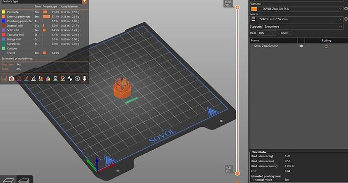

PrusaSlicer profile for Sovol Zero!
I’ve been (slowly) porting Sovol’s released OrcaSlicer profile over to my preferred SuperSlicer, but it looks like @TomsPrintGarden beat me to it! I’ll be trying this out, and I’d like to expand upon it, including lessons from the OrcaSlicer profiles thread as well as other layer heights from Voron Zero profiles etc.

I just tried the profile but when slicing the result is some invalid GCODE in the Start-GCODE where “F0” which leads to the cancellation of the print.
Did you succeed in using the profile from TomsPrintGarden? I also noticed that the Start-GCODE differs a lot when comparing to the latest profile in OrcaSlicer.
Found it: “Max volumetric speed” was set to 0, which leads to F0 by calculation.
I haven’t had a chance to try it the profile until today, and it also cancels for me until max_volumetric_speed was set. This is a printer parameter, not a filament parameter, and one that I can’t find in Orca, so I set it to 68 55 mm3/s based on the external_perimeter speed of 175mm/s & a 0.4mm nozzle (see next post)
I was having trouble with my own Start-GCODE, but for different reasons, so I’ll compare the two in detail
@sebastianha , I think Tom’s starting g-code only differs from Sovol’s June 23rd Orca profile Sovol-OrcaSlicer/Profiles/Sovol Profile at main · Sovol3d/Sovol-OrcaSlicer · GitHub in the following ways:
  • Heats & waits for extruder temp prior to START_PRINT macro
    • Personally, I disagree with this; the START_PRINT macro has to go up & down a lot as it is for bed leveling, nozzle cleaning. Leave it to the macro, reduce the amount of oozing. Both the bed and the extruder are so fast anyway
  • it uses max_volumetric_speed (which caused the problem you noticed) instead of outer_wall_volumetric_speed, which doesn’t have an equivalent variable in PrusaSlicer
    • So my earlier 68 mm3/s guess is way too fast
    • Volume should be thesame as external_perimeter_speed*layer_height*external_perimeter_extrusion_width
    • However, the /(24*20) implies (I think) that it is converting this volumetric variable to linear, so why go from linear, to volumetric, back to linear? Just external_perimeter_speed should be fine, which is conveniently shorter, a nicety since this variable is used on basically every line
What other differences do you see? Are you starting from the same Orca profile I am?

 G1 E-0.2 F{ 10 * 60 }
 G0 Z1 F{ travel_speed_z * 60}
{else}
 G0 X{ print_bed_max[0] / 3 } Y0 F{ travel_speed }
 G0 Z{ layer_height } F{ travel_speed_z * 60 }
 G91
 M83
 G1 X{ 50 } E{ extr_per_mm * print_bed_max[0] / 3 } F{ prime_speed }
 G90                                                       ; Absolute positioning
 M83                                                       ; Relative extruder
{endif}
SET_PRINT_STATS_INFO TOTAL_LAYER={total_layer_count}
@rpcyan Nice! I was thinking about posting my latest revision for the start g-code which had tweaks to remove hard coded constants with slicer vars or user defined local vars. But I see you did similarly plus quite a bit more.
The start code purge line has been working excellently for me. I have been consistently getting a clean start to my prints with minimal waste. I stopped using a skirt and don’t see much point in ever going back to one except maybe to confirm bed adhesion around the entire print area on a sketchy build plate.
Another thing I’ve done which helped improve my print start consistency was tweaking my NOZZLE_CLEAN and START_PRINT macros. I was using one posted in this forum but changed it to move the nozzle over the scrubber pad before heating the nozzle so any ooze goes in the scrubber instead of on the build plate. I heat the nozzle hotter, 230 instead of 200 and scrub starting slow but with increasing speed and more zig zagging. This has been working well for me with PETG and ASA where previously it sometimes failed to clean the nozzle. I expect for some filaments nozzle cleaning even hotter could be better but haven’t yet looked into adjusting the nozzle clean temp based on the filament about to be printed and/or the one previously printed.
Please let me know if you try out my latest starting code, and post if you have any modifications (or requests)
I admit to mostly being PETG, with a little PLA so far, so I haven’t had any nozzle cleaning issues yet. I do have a couple spool of ASA and TPU just waiting for some free time, so I wouldn’t mind trying your tweaked macros
Wow! there has been a lot of traffic on this! I’m just getting back to this machine and playing with profiles again and have been trying the Prusa fork, here.
