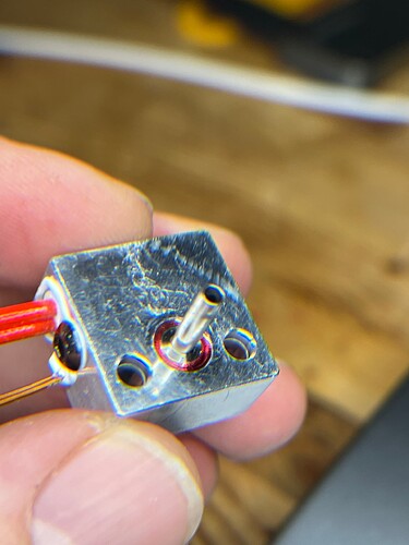

I sincerely hope that you’re wrong about this. How would they expect you to install a new hotend if the heatbreak was glued in? Likely, there is some thermal paste in place which might be making your heatbreak difficult to remove.
Glued in … but I was able to peel it off an get it out with enough heat from a heat gun.
Thank you for this! Are the thermistor and heater cartridge also glued in?
Extremely disappointing behaviour from Sovol3d.
Yes … but not as hard as the heatbreak

How is the heatbreak fixed?
Is there a screw somewhere?
It’s screwed into the heater block and glued into place.
