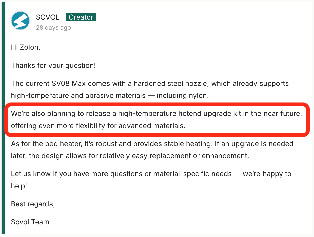

When will this upgraded hotend be available?
:down_arrow: from kickstarter comments.
Hi,
I would be tempted to say, “in the near future.”
:joy:
