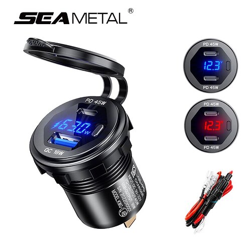

Input max 28 Volt
Output 3.3 - 5 - 9 - 12 Volt
Put a reverse polarity protection diode in front of it
