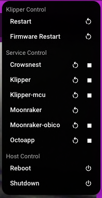

In the mainsail interface your are able to turn of the host.
Maybe you can investigate the chrome browser tools to see which request it makes when you use it?
Is that an option? Or did i misunderstand your request.
Indeed, shutting down the Linux system is possible from Mainsail. But what I would prefer is something more like the setup you’d get when Klipperizing a “traditional” printer using a separate Raspberry Pi. I want the Linux host (and thus Moonraker + Mainsail) always on, with the printer MCU (and heaters, etc.) powered via a separate supply (that I can switch via smart plug).
In that setup, I’d be able to use Moonraker’s power control support to toggle the smart plug controlling the MCU directly from the Mainsail Web interface. Whereas right now, when the printer is powered off, Mainsail and Moonraker are not running (because the Linux SoC is not running :slight_smile:).
If there were some way to power the Linux SoC on the mainboard independently of the Klipper MCU, then this would open up some neat possibilities in terms of power control, etc. But the more I think about this, the more I suspect the setup I want is just not practical given the Mainboard setup Sovol chose. It’s not the end of the world, and I think the all-in-one board Sovol used is probably a good default for most people, but it is a bit limiting in terms of flexibility.
