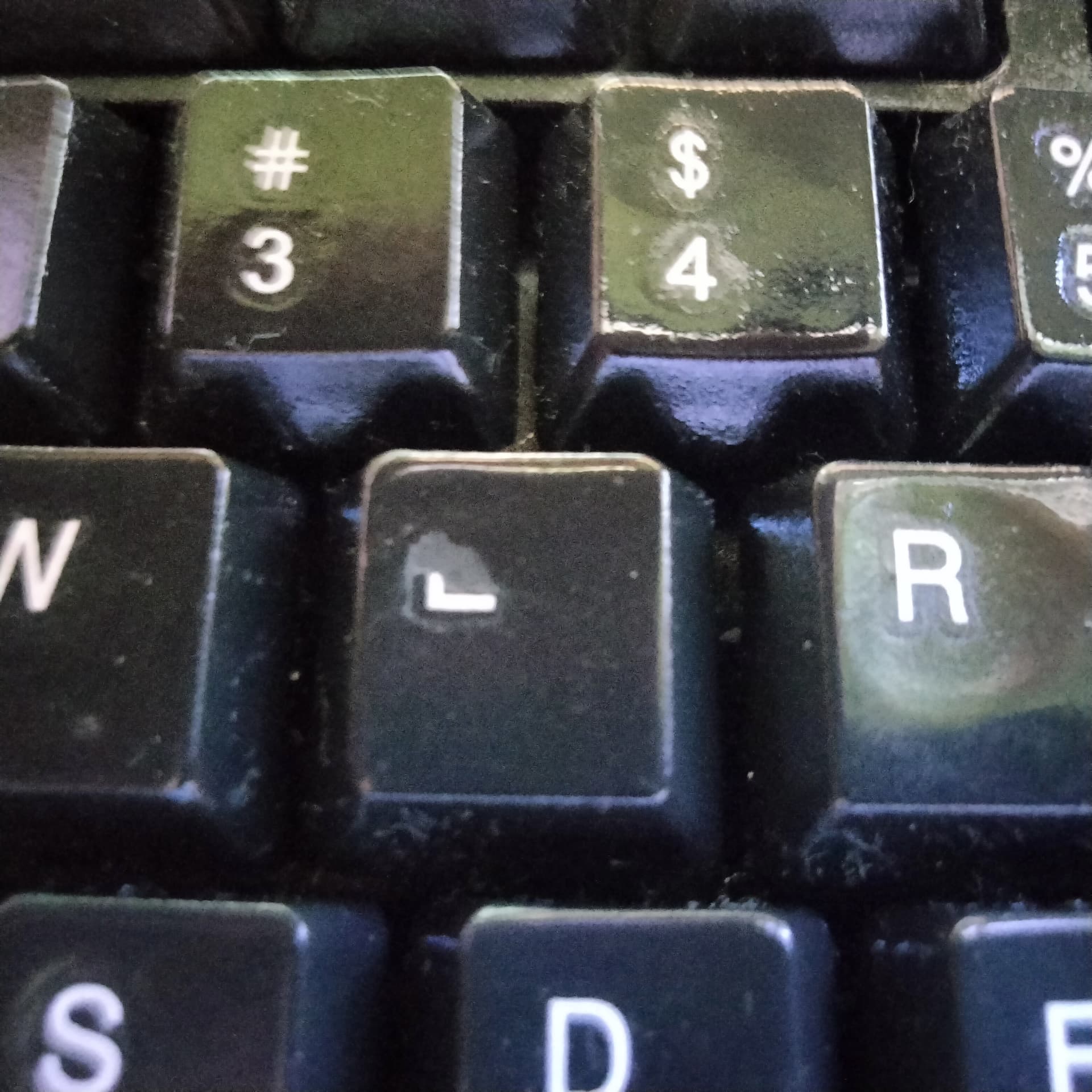

Just wondering if any of you have 3d printed Key caps. I’ve been able to find plenty of STL files but all have been plain generic caps.
What I’m looking for is/are STL files that allow the keyboard character to be printed in another color on the top of the replacement key.
Ideas?
Can you post a pic of what your looking for.
From your post, it just seems like it’s a 2 color print.
Hi there Lion. Glad to be back in touch again.
The attached photo should explain what I’m wanting to do. Print replacement Key Caps for my keyboards because the lettering never stays intact very long.
As an example of my thinking. I’m looking for STL files that would allow me to print the Key Cap in Black, with a white letter also printed.
I’m figuring a white printed letter would last much longer than the paint most keyboard manufacturers use and never lasts very long.
So yes, a two color print. I’ve found files for one color, but none to add a contrasting color as a character.
