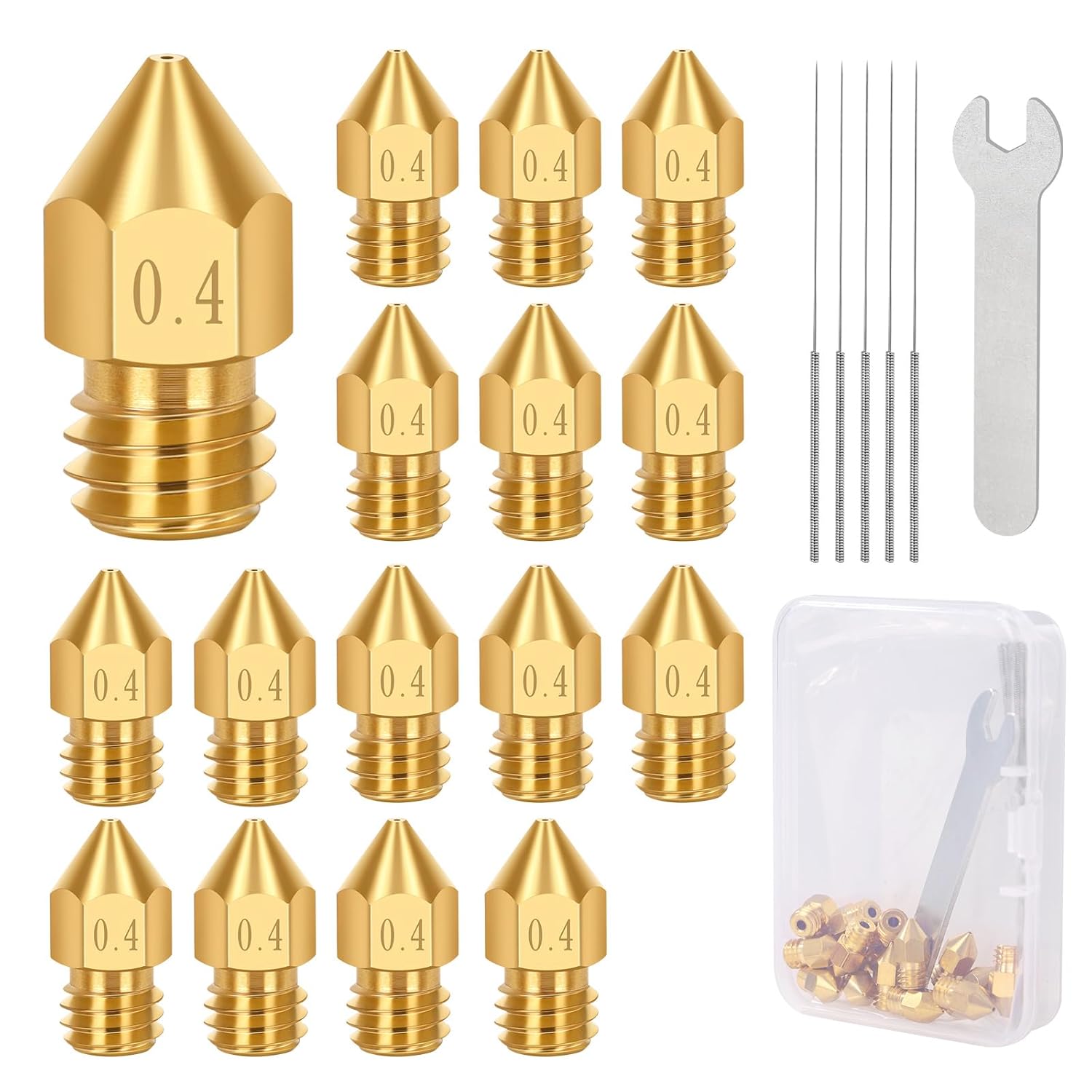

Put a cookie sheet (or similar) over your build plate and the worst that can happen is a ruined nozzle. The Zero uses the most common one in existence. Buy a dozen junk ones on amazon.

BTW I’ve had fair results with CHEAP brass nozzles and PLA. Name brand do print better but until you get the printer working stick with the throw away ones.
